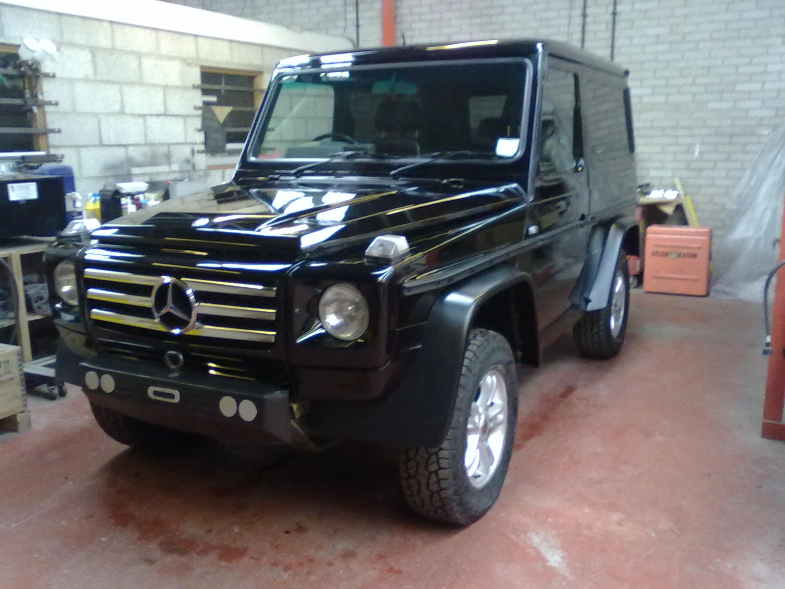

just the bumpers to fabricate

hi steve. it looks good mate. very good !! wheels are my only issue unless you have mentioned your plans..

Steve - like many others i have been watching this transformation with great interest - my question is about your front end - in order to fit the 463 headlight surrounds did you have to fit 463 front wings?

Morning james .....No  the wings are the standard 460 items..i just manufactured brackets to fit the headlight surrounds and i used stainless "bighead" bonded fasteners for the lowerpanel side fixings.

Just been scrolling through your pictures..........fantastic job. I didn't realise you could fit later headlight surrounds/grille. Looks far better

thank you....opinions seem to be divided..many seem to prefer to keep old g's original....i just like the 463 look with the simplicity of 460 mechanical's....its been a fun 12 month project though.
