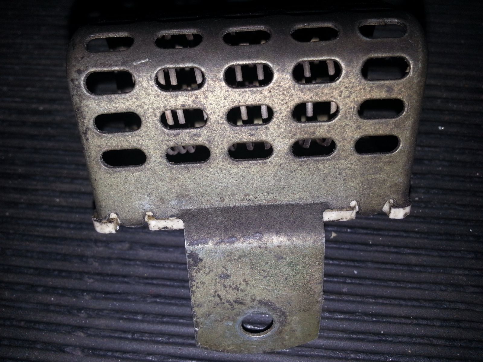

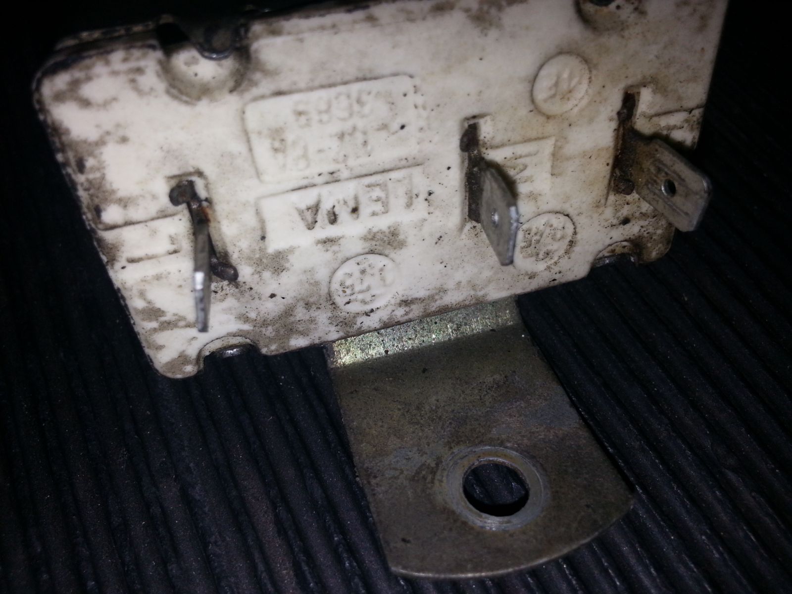

Hi All,
The heater fan is only working on "full bore". My mechanic has identified what he thinks is the rheostat controling the lower fan speeds.
It is situated under the bonnet and bolted to the side of the box that looks to contain the cylindrical heater fan. It has three wires connecting to it.
The MB dealer asked us to remove this supposed rheostat and has now commented that it looks like a non MB part as he can't find it on the parts schematics. My mechanic thinks it looks like it belongs there.
The question is, who's right? Any help on this appreciated. Here's the pics of the little rascal ...
The W460 have the rheostat mounted in the heater box its self (Big job). I have two part numbers and these are dependent on the heater box number.
Rheostats mounted on the vent box in the engine compartment are on the W463. Unless some has modified your system.
Is there a part number on the old removed unit?
Your full chassis number is needed to proceed further.
My 463 (early ) nrheostat mounted in the heater motor,a big job as you say.
Did buy an external rheostat that looks similar to that one in the pic, except connectors are different.
Can you dismantle and relace the broken resistors and replace unit? Tv repair shop did mine
Certainly does not look like the strandard 460 resistor... they are mounted inside the cabin on the heater box normally although there are more than one type
If you can send me some pictures direct to my email (will PM you it) and i will try to identify, the makers name and any numbers will be of most interest...

It must be possible to replace the resistor within the unit? If I remember correctly, there was a resistor inside a metal shield that you could probably dismantle and replace what's needed?
Cheers Scott
Yes, just looked at your photos, not sure if you could easily find something to repair that. That's definitely what I had.
