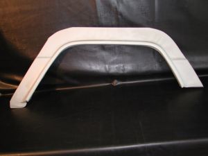

been to merc to order inner wheel arch panel, as you see in pic its the big gaping hole in the wheel arch, now we can find the inner part to the right of it but the part thats missing is it attached to to the inside if i purchased a new mb rear quarter ? if anyone has bought a new rear quarter from mb your comments would help us move quick on this...... Cheers and happy new year

Could do with a side shot, but in my view as a non body worker, I feel you need the wheel arch panel and inner wheel arch to fill your gap. I don't know if a part arch panel is available which I expect would be possible as an after market item.
I would expect you probably need the rear quarter panel as well.
At minimum, you could get away with a wheel arch spat panel rather than the full panel and patch up the inner wing; parts allowing.
Please furnish your chassis number.
Picture of wheel arch spat at €54.00 plus postage.

It looks like a good place to smuggle drugs !surprise , thanks for the replies dodgy polish repair panels but you can get a exterior mb oe panel for approx 135 plus vodka and tonic , has anyone bought one and does that part of inner wheelarch come attached ?
Re: Inner wheel arch panel required
I had new arches put on my 463, wasn't quite as bad as that, you need to look at EPC, to see all inner panels, in the end bodyshop fabricated a piece, to save a very long wait
No that piece does not come attached, unfortuantely

I had checked on MB EPC this morning but it doesn't show it at all .....anywhere ! i was hoping for stat man to surface on this issue.........

Hi ScouseG
Does the attached help?
Or is this where you're at already?
I think Item 5 on the second picture is what you require....
Figuring you must get something extra for your additional £244 quids...
(Assuming this is a SWB 460 series G?)

yeah you can see it sticking out the bottom on item 5, i knew me eyes are goin, i need eyes like a s***house rat, cheers gav , check this out we're gonna change it to Stat Man.... http://www.youtube.com/watch?v=cbWRX5vGPo4&feature=youtube_gdata_player
