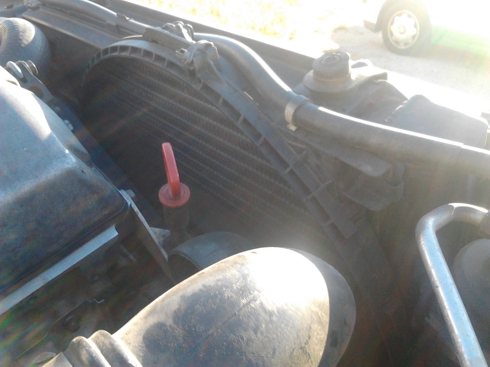

Re: GD350 problems - new radiator capacity and engine cooling
Hello and welcome to the forum Antonio,

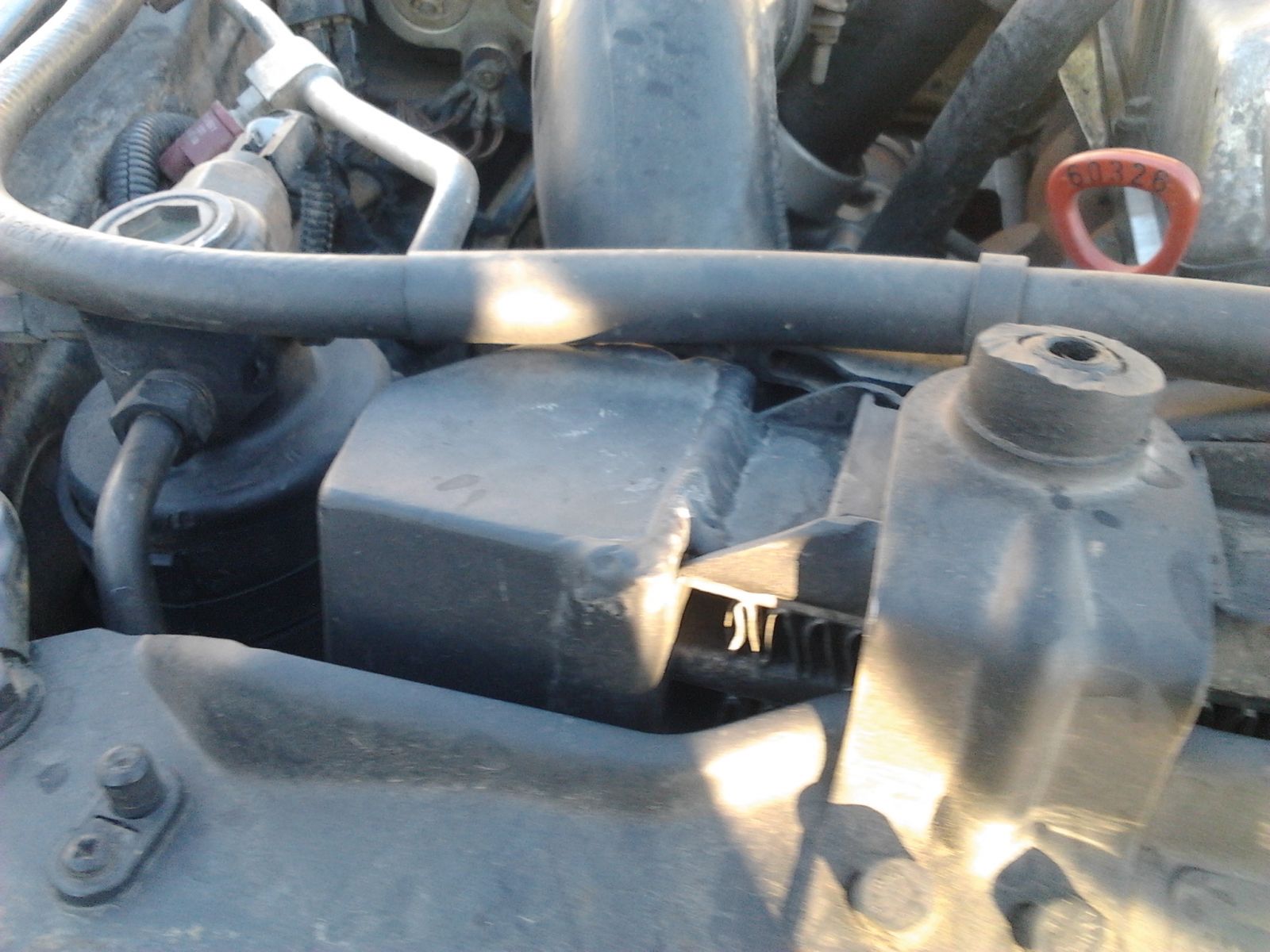

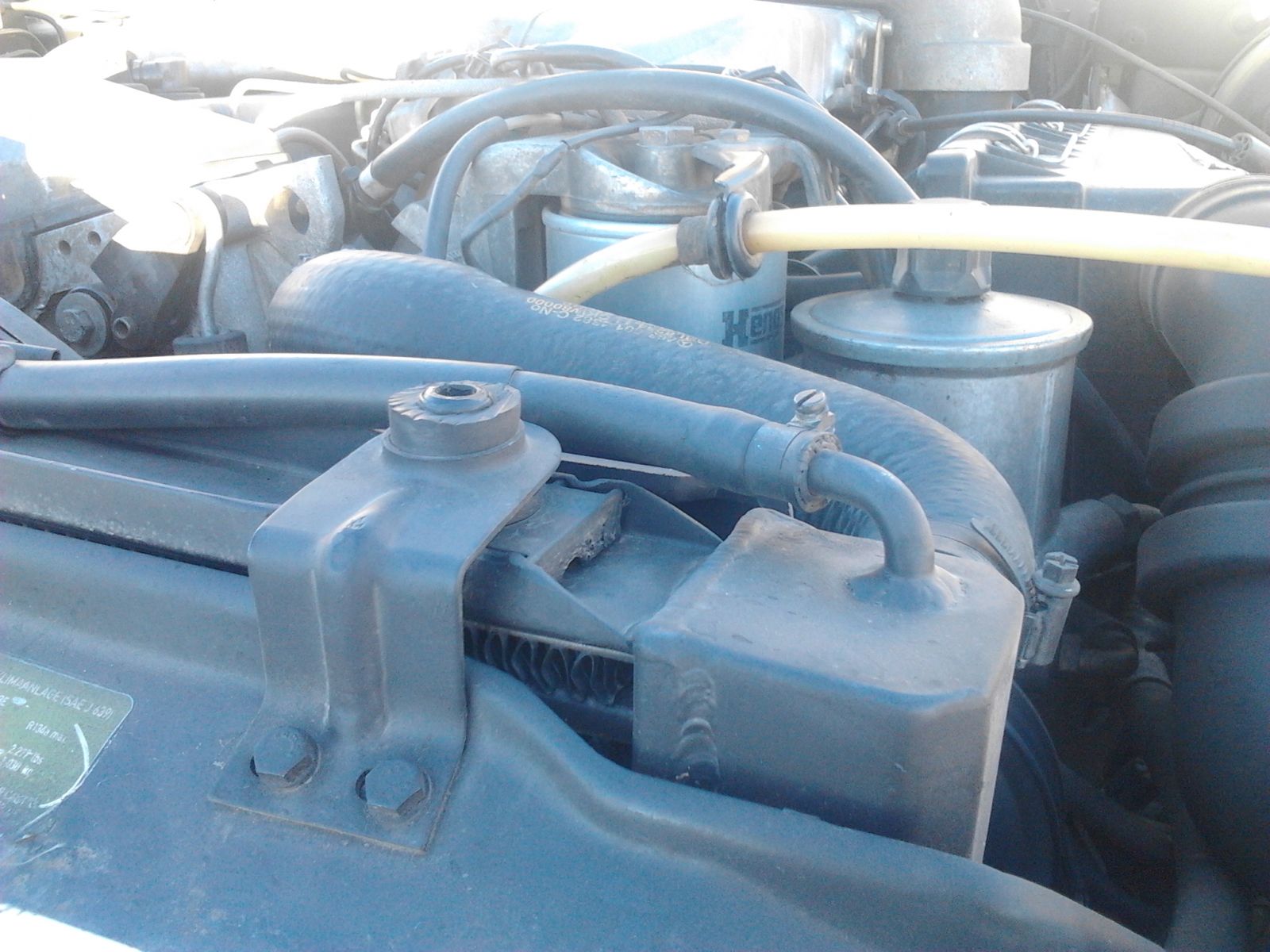

Would it be possible to post a picture of your new radiator? I am interested in its design, in particular the Header tanks.
My suspicion is that you are left with an air pocket in your system that compresses as the radiator pressure builds up.
My initial suggestion is to jack up the front of the vehicle as high as you can and fill the cooling system. Did you measure how coolant you have topped up in total? Alternatively fill up the system using these modern vacuum filling systems. Do see coolant freely flowing from the radiator's over flow pipe to the expansion bottle?
If there is water in the cylinder head, you would expect a plum of white smoke during start up.

Regarding the radiator, we just copied the old one, bigger sides and took from old one that was 2 yrs old the inside exchangers, oil and auto gearbox.

We just copied the radiator and I did not think much about it, now I've the problem I've switched my brain....

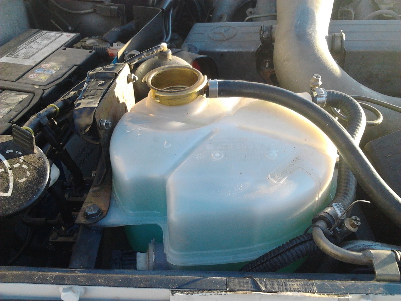

Hi everyone.
it seems problem is solved, although expansion cap was new, it was a 120psi and indicated for this vehicle is 140psi.
I've been now running in hot summer days in Portugal and the level mantains and no more expeled coolant.

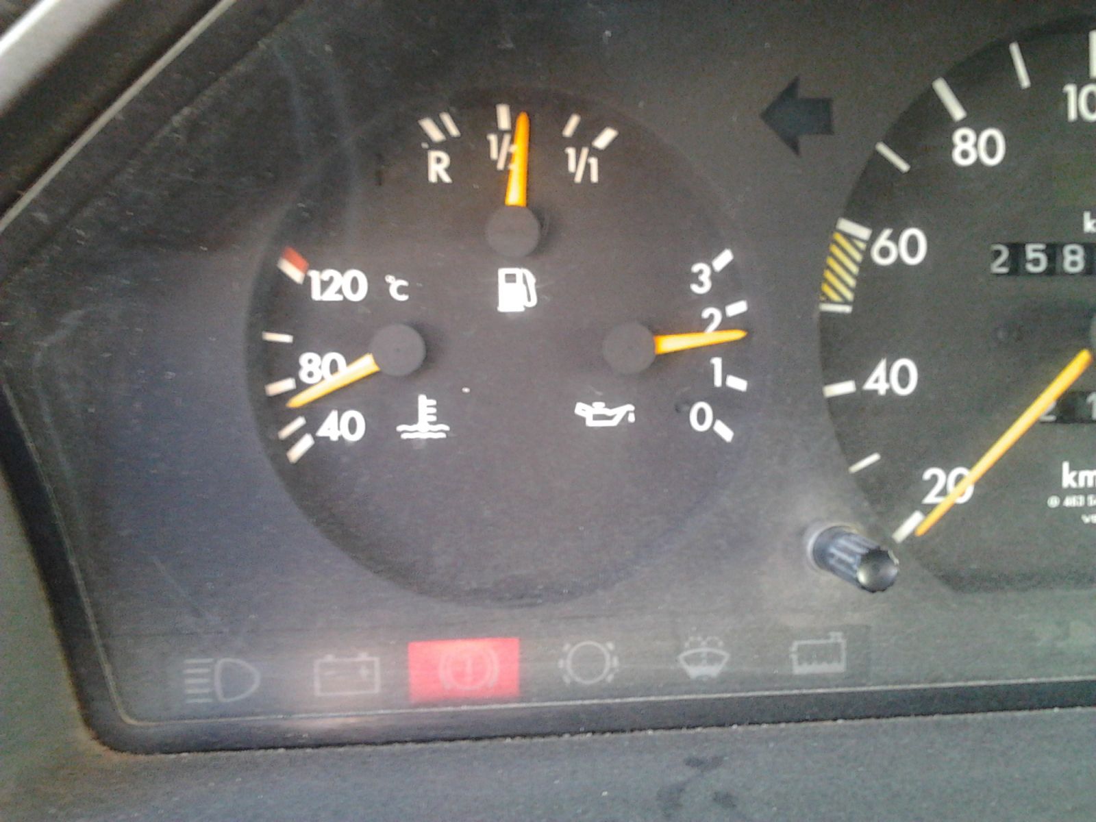

New (603.972) mounted, 190k.
At least now we can open the epxansion reservoir cap, no pressure at all, that's a good feeling.
Engine runs well, I've a bit o trouble with vacuum lines, the gearbox change is more harsh and it seems turbo is not giving it the full power.
Engine temp around 80, with full gas for some time around 85-90ºc.
So, I think in the good line of work.
BR
Antonio
