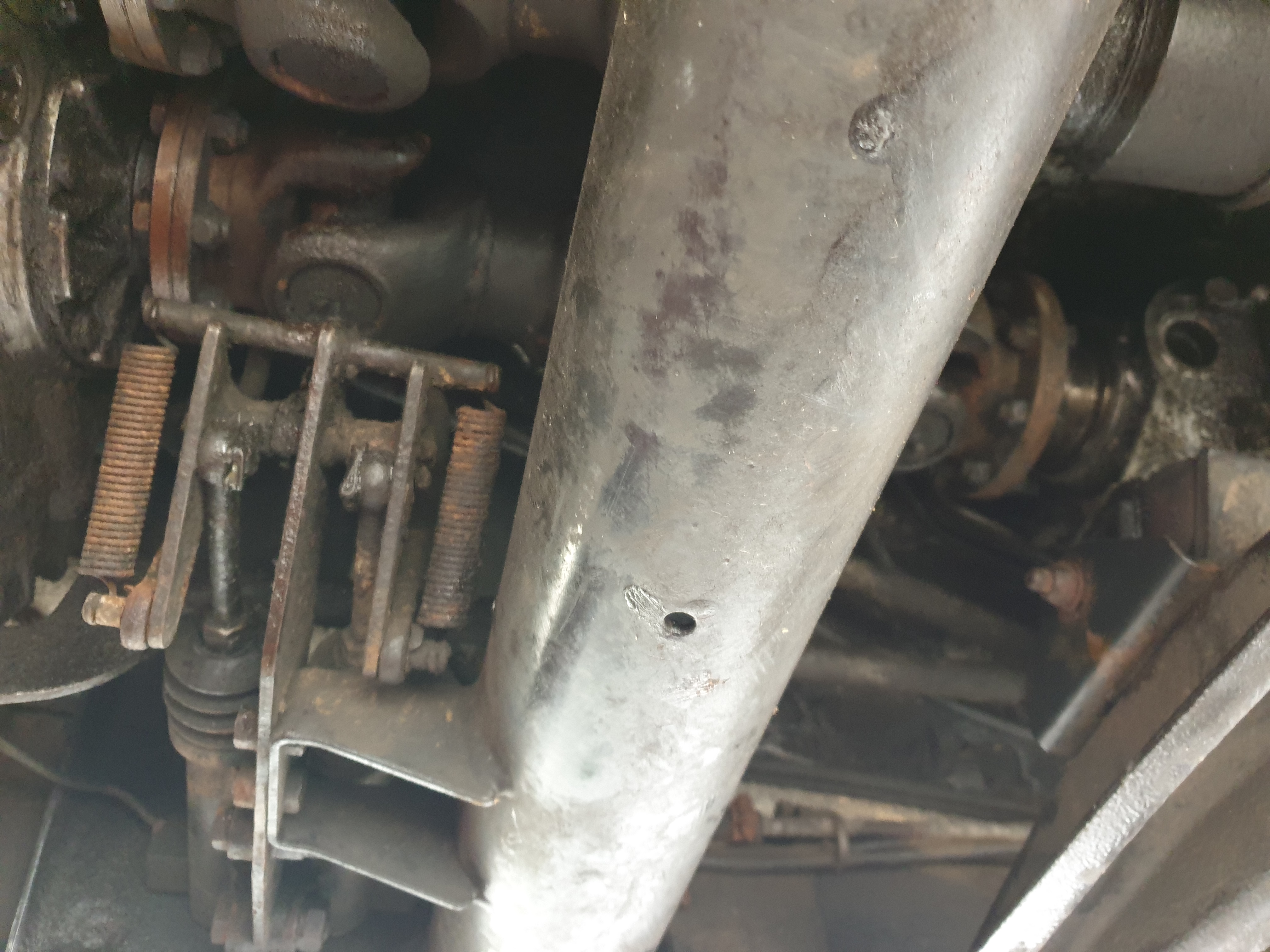

Ok, so I know this is a well covered topic, although I have not been able to find any real clues (and admittedley most posts on this site were nearly 20 years ago!) - but how the hell do I remove the centre propshaft! Of the 16 nuts (8 each end) not even managed to loosen 1
Can get spanner on, but as only partially and slight angle due to everything else in the way am merely 'rounding' nuts (and even made thinner spanner and cut to provide tighter fit than standard 13mm - can only use open end as nut so close to yoke).
Why? Am getting vibrations as speed up (feel them > 30mph), horrendous around 50 mph, then loosens but not away. No vibrations can be felt in gearstick, but transfer box (4WD selector) really vibrating. No steering damper issue (familiar with those), wheels balanced, tracking OK, no obvious suspension issues and bearings all done. OR is there something else I might be missing?
Managed to remove rear propshaft (only 2/16 needed angle grinder, at least had access compared to centre propshaft, see image) and had specialist check and no obvious issues, hence wishing to try prop linking gearbox/transfer case... and failing spectacularly. Can't feel or see anything wrong (so happy not to remove if can avoid), but is next on my search for cause as driving is not pleasant.

Hi Gav - thank you for all the points! Vibrations through the whole car, can feel it through seat. Am familiar with steering issues and this is very different. Was very disappointed when rear-prop checked out OK, means need to keep digging!
YES, have looked at damper (images attached - and yes, spot angle grinder damage required to remove 2 x rounded nuts). No service required, it is very heavy and basically 2 x large rubber washers encased in metal and held together with 6 x bolts and then the 8 x prop bolts.
