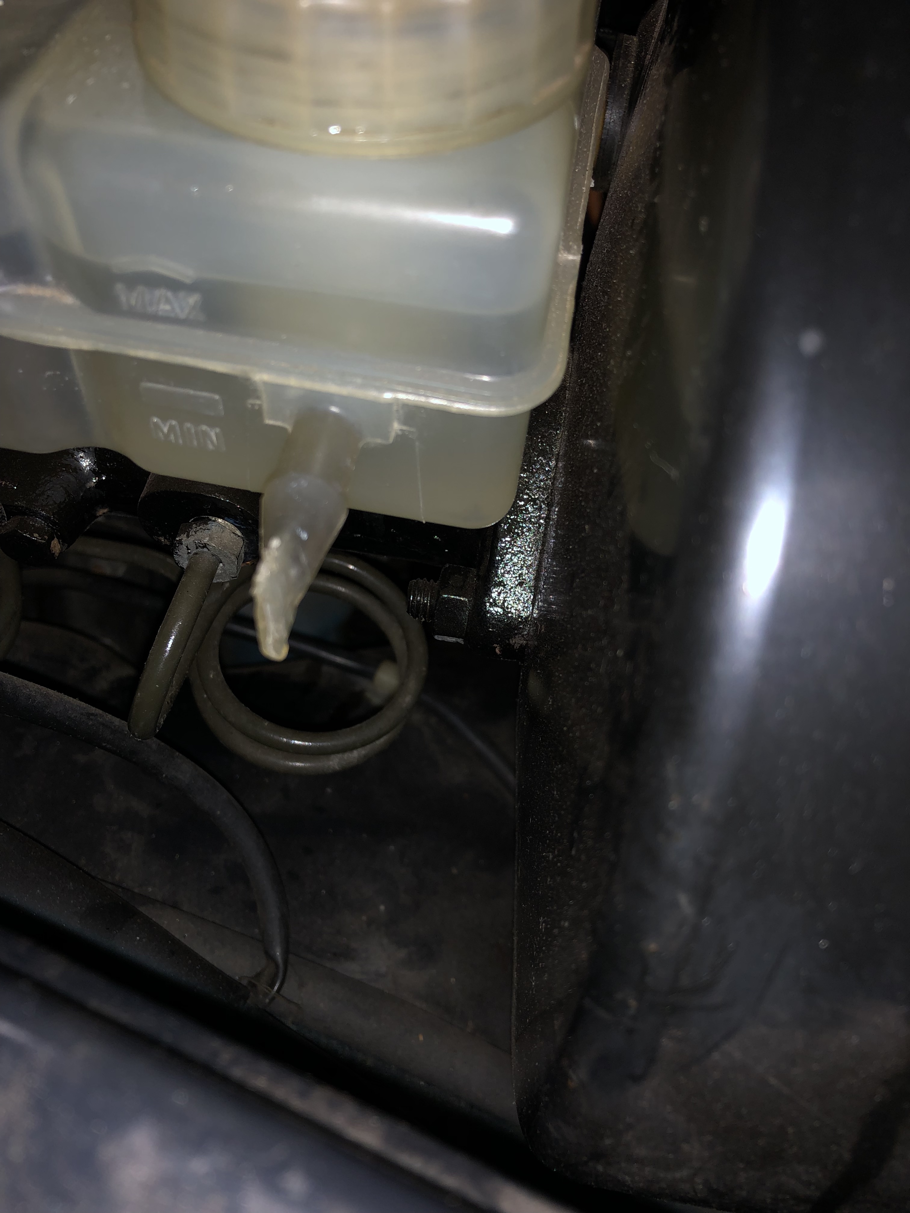

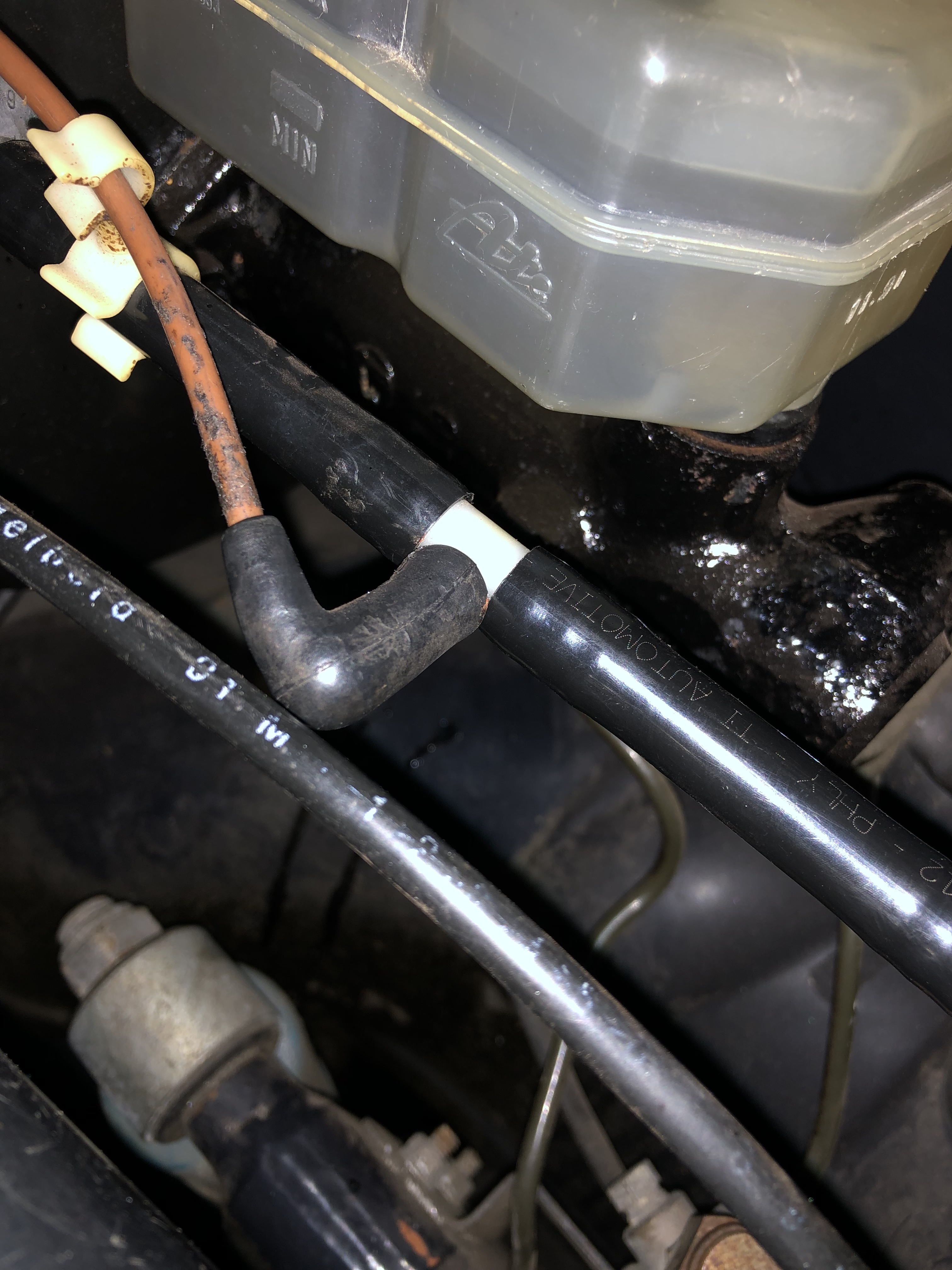

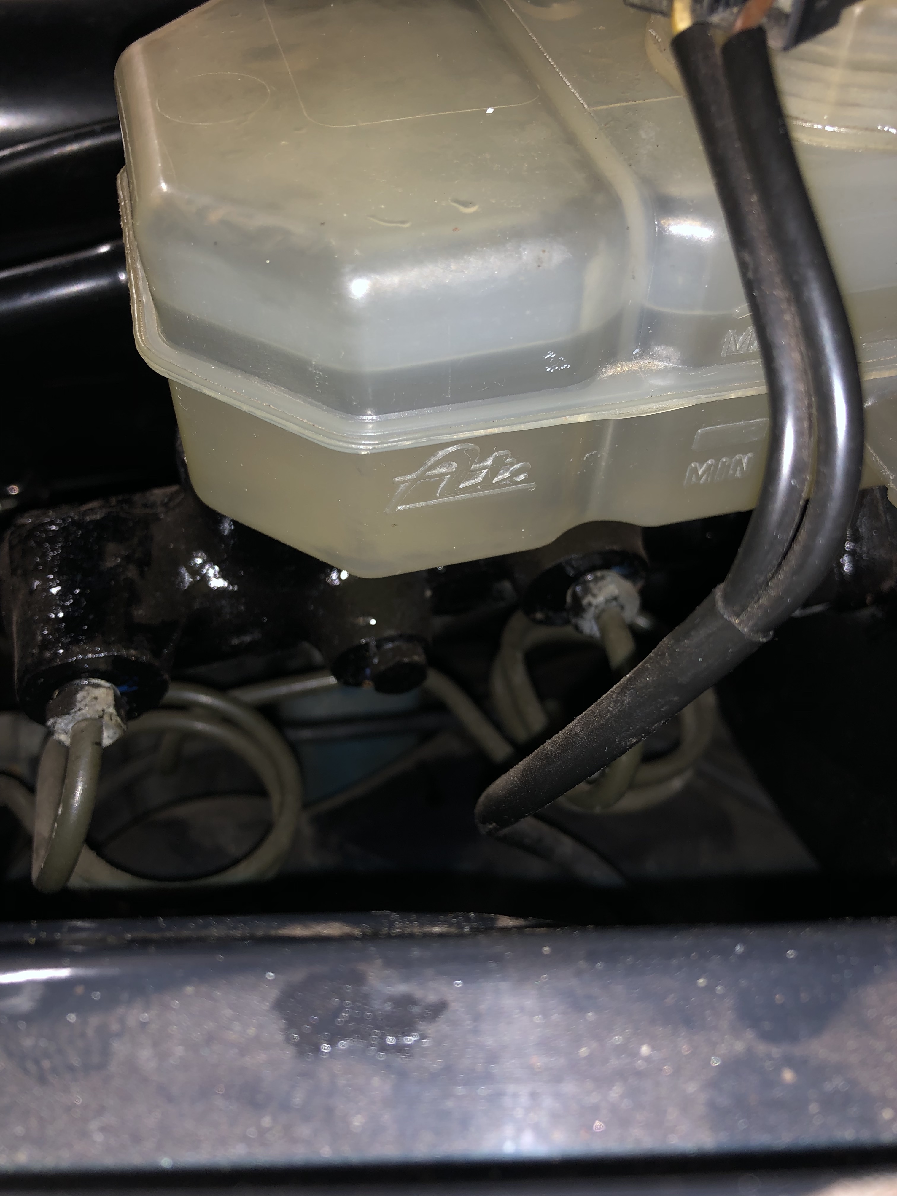

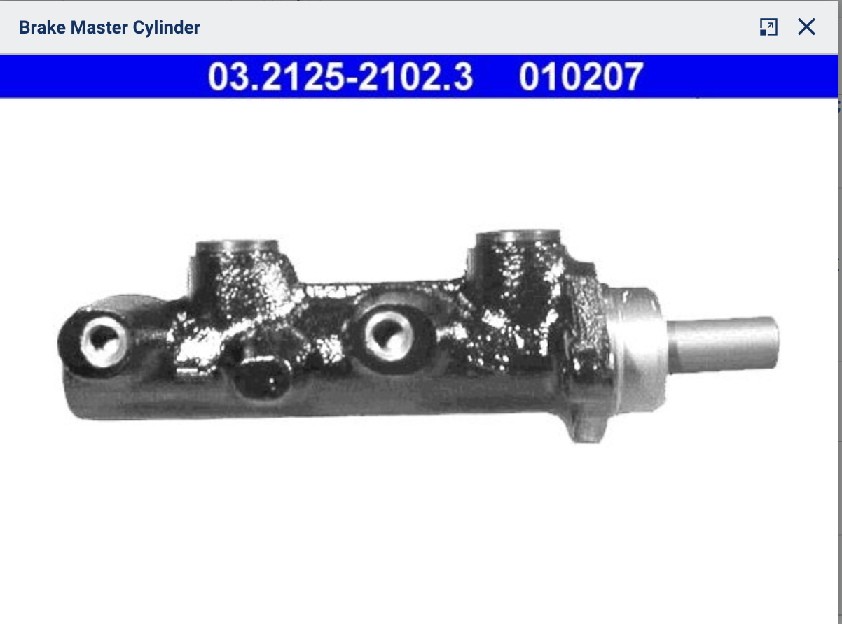

Good day all -
I have a 1992 300GD, W463.328.  After rebuilding the axles and front brakes (these were the Perrot calipers and with the standard kit of seals and pistons, they rebuilt beautifully) , I am now in need of a new brake master cylinder or a rebuild kit.  After much research, I am left confiused.
p\Part numbers from MB say 005 430 38 01 and 005 430 44 01 for vehicles with antilock brakes.  My vehicle has the antilock servol..
For vehicles without antilock brakes, the part number is 005 430 29 01.  This is an ATE part, number 03.2125-2102.3.
Confision point 1 is that the brake part numbers seem to wander between 005 and 004 as the leading digits, yet the parts seem the same.  There are also several parts listed (i.e., teh 38 01 and the 44 01 parts both being the same function) yet, EPC doesn't list one as superseding the other...
Confision point 2 is that the only unit I can seem to find anywhere is the 29 01 part number for vehicles without anitlock brakes...  I cannot find a 38 01 or 44 01 for use with anitlock brakes.
Confusion point 2a is that the master cylinder on the vehicle now looks IDENTICAL to the 29 01 part that is supposed to be for vehicles without antilock brakes, yet my vehicle has anitlock brakes.
Can anyone help with the confusion?  What is function difference in a brake master cylinder when used with or without an antilock servo?
Thanks so much for any input.

Re: W463 Brake Master Cylinder
Send me you VIN and I will look
LHD and RHD differ
Manual and Auto sometimes differ!
Early and Later types differ with internal bore size although look identcal
ABS different again...
There is only one RIGHT one in theory!
Most will certainly bolt up and can be made to fit.... but MB designed all these difference for a reason ;0)
Chassis number had a digit missing off the end so assumd its WDB 463328 17 082590
German market LHD model sold new in Frankfurt
So A005 430 38 01 is the correct number
No longer available at MB
Optional number A005 430 32 01 also NLA
Cylinder looks to have been around £520 when available
G specifc part and fits only early 463 and some similar era 461 models
Can't find any aftermarket options available and the odd supplier that lists it new MB is just pulling from the MB price file and when you order they will take your order and then decide in a months time they can't supply and you will eventually get your money back... ask me how I know!!
There is a Repair kit A005 430 37 01 that is available in Germany at MB at around £315 and this is the only viable option I can come up with for you!
A dealer should be able to get you one in a week or so and I am sure will be a comprehensive kit and will make it as good as new!
Or shout if you need assistance...
