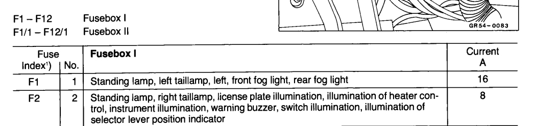

you are not a full member so cannot get to the docs and wiring diagrams in the members sections, so here they are.
You need to see what the Fuse 1 is covering, and find the ground or short circuit there. It sounds like it could be in the wiring loom, behind the dash, rubbing through onto metal. Just a wild guess at this point.
