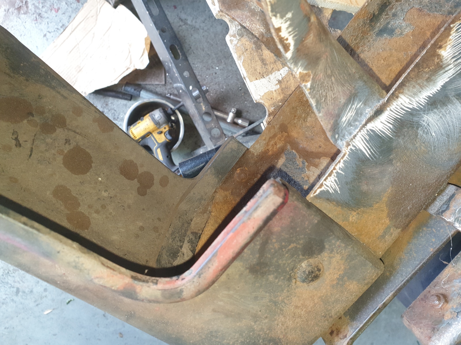

Trying to remove plastic bumper ends - attached by top and bottom bolts (see very unexciting pics, apologies nothing like the exciting Unimog). Can get the bolts rotating, but this includes the rounded outside part and not found a way to lock these, hence nothing coming undone! Is there a trick to this???? [or is it case of destruction via trusty angle grinder?] Thought rounded outside bit might be just a 'cap', but not so sure having tried to remove.

They're just standard coach bilts
But the square section under the round head has probably rusted away
Grind the nuts off underneath
MB ones aren't cheap M6 x 20mm or so black coach bolts on eBay are cheap
