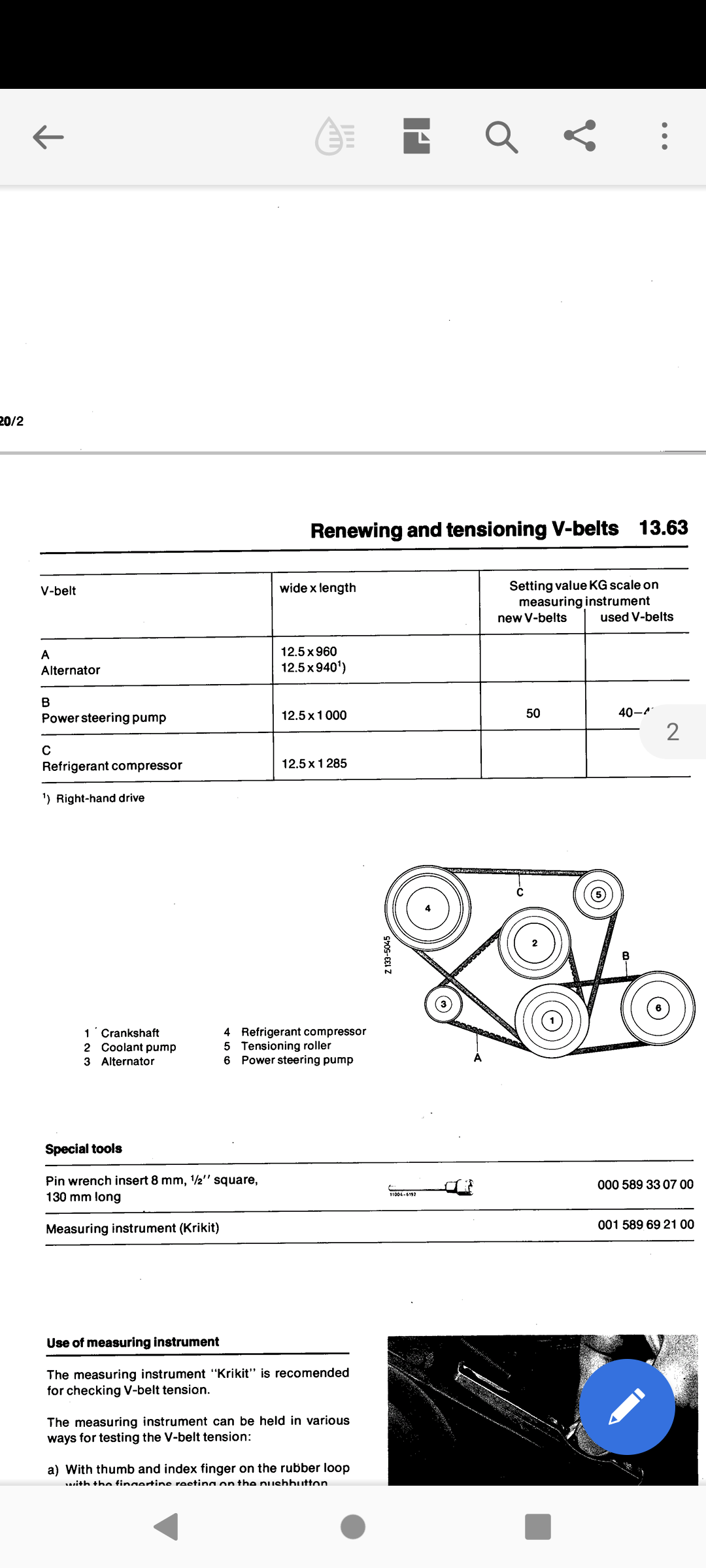

Hi. 230GE engine Not the fan belt, but the power steering belt... How to tighten it? The fan belt is easy, just loosen the lock bolt and lever the alternator until the fan belt is the correct tightness with about half an inch of play. But the belt behind that seems to have no such adjustment. I'm getting slight belt squeal on starting.
Re: M102 loose fanbelt
I'm non the wiser from the owners manual.
