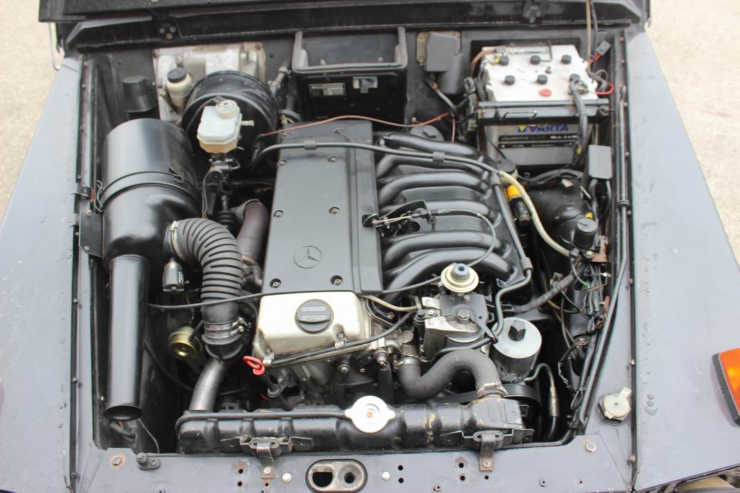

The finished product
| 1 of 1 | Back to gallery |
We aim to make the conversion look as "Mercedes" as possible with as few bespoke parts as we can

it's a very neat installation
Re: The finished product
Thank you, I've aimed for it to look as "factory" as possble,

what do you think the turnaround time on a Wagon would be to get this done?
We get the engine and gearbox pretty much done on the floor, that's the way I've designed the conversion, so there is a minimum of work to prepare your vehicle, and only minor modifications are required. so would estimate a two week turn around.
This would depend on what model G, what engine, and what gearbox the vehicle comes to me with, we currently don't offer and autobox option because of final gearing issues but this is something we're working on.
We're bringing a 460 from Cork in the new year and delivering it back done when we come over to Dublin for Eddies Valentines bash.
Gordon O

Looks good (read wonderful ) so what is the best (read easiest/cheapest) 460 for the transplant treatment.
I suspect it is a diesel / manual.

Yes, diesel/manual is the easiest/cheapest because everything is done, glow plug relay, pedal box, vacuum shut off etc
