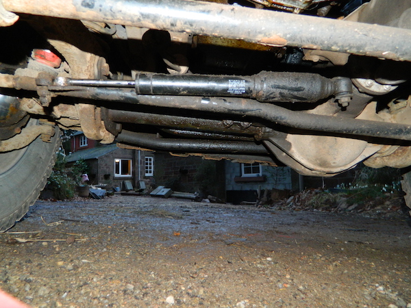

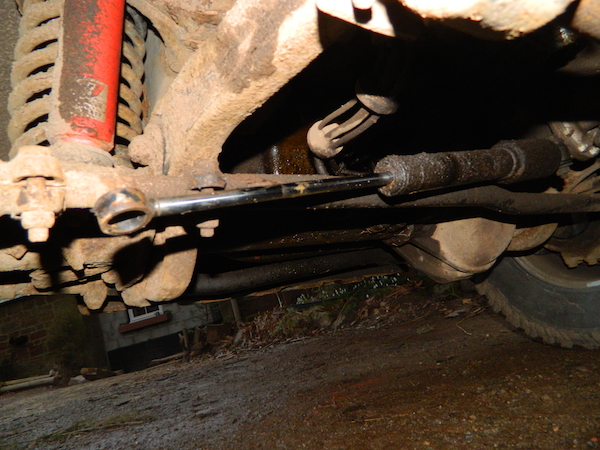

My G has just returned from some welding on the chassis and I have found that the steering damper has lost its bushing and botlts, etc.
I really do not want to purchase a complete new one as this one was working fine, but Mercedes tell me that they do not sell the bushings seperately and I will have to purchase a complete new one.
The Steering Damper i have is a Stablilus.  Do you know where I can purchase a bushing for it?
Your help and assistance would be much appreciated.
Barry

I'm afraid that you will have to search around for something that fits, unless someone on the forum happens to have a spare from an old or worn unit. Sometimes MB will say that parts are now only available as complete units, only to find that when you collect them, they actually come in two or three separate packs with separate part numbers. However, I think the steering damper only ever came as a complete part with the bushes. However the mounting bracket and fasteners are separate items.

MB will only sell you the complete damper, if the other end is ok, an engineering place might be able to make one,? Its quick to remove!

When you do refit I highly recommend that you add a big fat heavy duty washer to the outside of the bush. This isn't shown on the MB system as necessary. I fitted a new damper to my 1993 463 and just over a year later I suffered the same problem as you. I couldn't find anywhere to fit a new bush so purchased and fitted a new unit plus the washer. No problem so far.

Look on the net for void bush suppliers. I found some bushes but forget who i got them from
The other option is poly bushes
Just measure the outside of bush and the pin size
Make sure the steel sleeve of original bush is still not in damper or you wont find anything to fit
Often the rubber inner bush falls out but the steel sleeve is still in the damper. I bet it is
