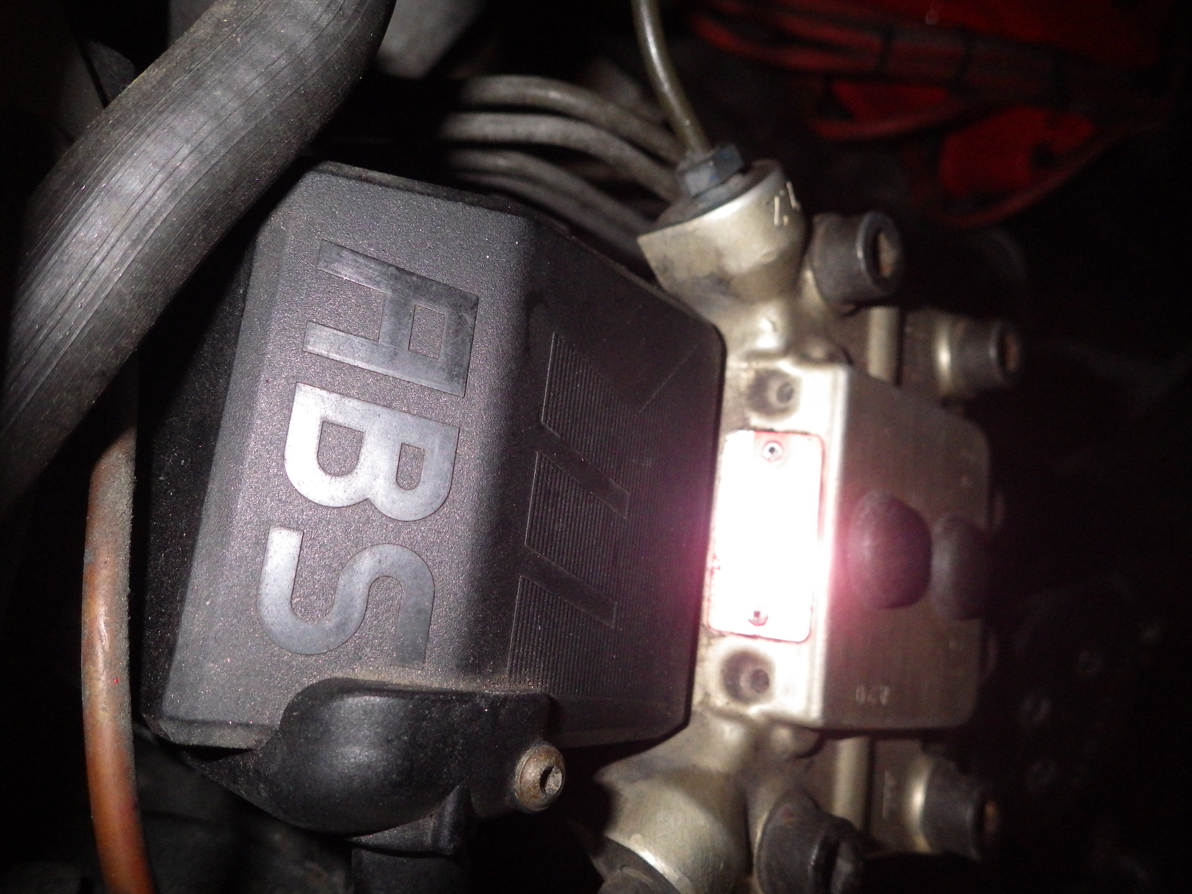

My G is 300 GEL 1993 and it is experiencing a problem with the ABS unit.
Every now and then the ABS unit emits a whirring noise like as if a small fan is running this continues for a while after the engine is switched off and normally stops whirring after a short while however this time the noise coming from the ABS unit is continuous and only stops when i disconnect the battery, please can any member advise on how I can remedy this issue.
Regards from Les

Hi and Thank you for responding, The whirring noise is continuous and is coming from the ABS unit and in particular from under the small black cover plate,    it sounds as if a small fan is running under this black cover,  it is secured by one fixing screw,
Shall remove the cover to investigate  ?
I have left the battery connected now for around 2 hours and the whirring has not stopped and the ABS unit is warm\hot to the touch.
Any other thoughts as to the reason this will not shut down.
Also the ABS light also started coming on intermittently.
The brake fluid is old i am not sure when it was last replaced.
Also i have been getting a grumberling noise and some minor shuddering from the brake pedal
Thank you from Les
PS  i have just removed the black cover, and also the silver BOSCH relay and the noise has stopped, do you think the relay could be faulty ?

Hi     I ordered a new relay and collected from MB today {Cheapest around} I have just fitted the relay and I am please to say that the ABS pump regulator has not started whirring so hopefully a fix, the relay was not cheap at £33.12 but a lot cheaper than a replacement ABS regulator as quoted at around £1,500.00  from MB   Relay ref MA001 542 67 19
Also there is a second relay within the ABS unit ref  MA001    542 65 19 which is available at £49.20 from MB
