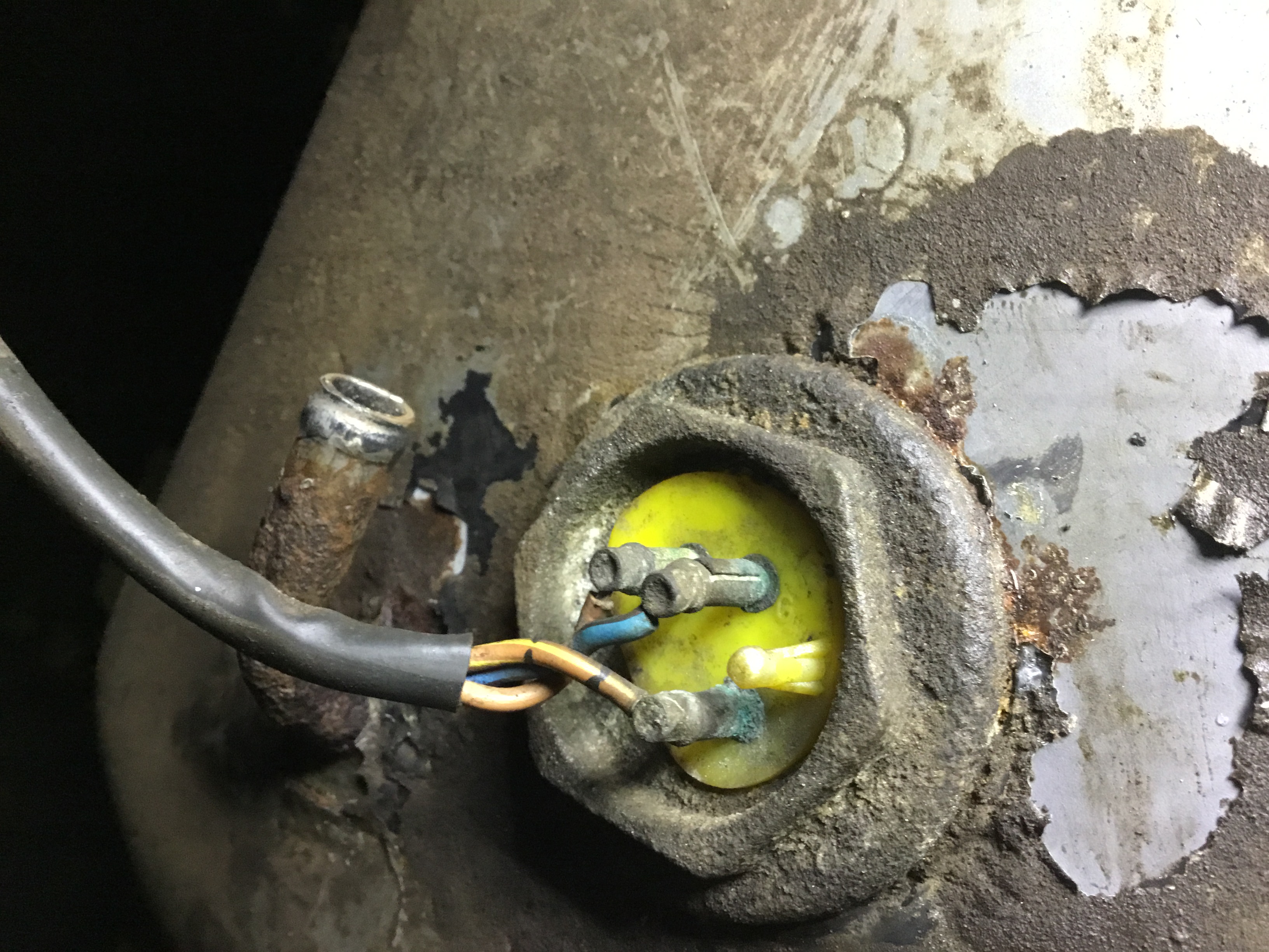

I have just started to look at the restoration of my 280GE and one of my first jobs is the fuel tank. I could smell the stale fuel but could not see the leak. I started looking at the corrosion and a quick wire brush soon exposed the first hole which helped me drain off the couple of litres of very stale fuel left in the tank. I dropped the tank and as i have read it was no surprise that the straps, bash plate and pipework are all completly corroded. I decided to try and remove the tank without opening the inspection hatch in the floor which was fine however i now have everything but the fuel sender disconected now. I would have expected a plug in conection however the connections appear to be soldered directly tothe terminals. Is this standard or a mod where a plug has been cut off in the past please ? Many thanks
The plug has been removed, the terminal ends are just pushed on , pull them off gently with some long nosed pliers
You won't get the sender off with grips , you will require a socket , there is a guy up by me who repairs steel fuel tanks

Thats greatthank you they came straight off. The sender wont budge now even with a big pair of grips so looks like i need toinvest in a 45mm socket. I have found a hole in the top of the tank by the breather along with the original underneath. I suspectthere will be more. I allso need need to remove the smaller tank bythe filler as i suspect further corrosion. There were years of silt and mud stuck in the many nooks. The small bracket holding this tank is very corroded and the nuts wont budge at the moment. All good fun.
